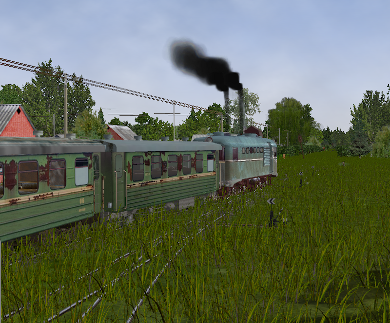

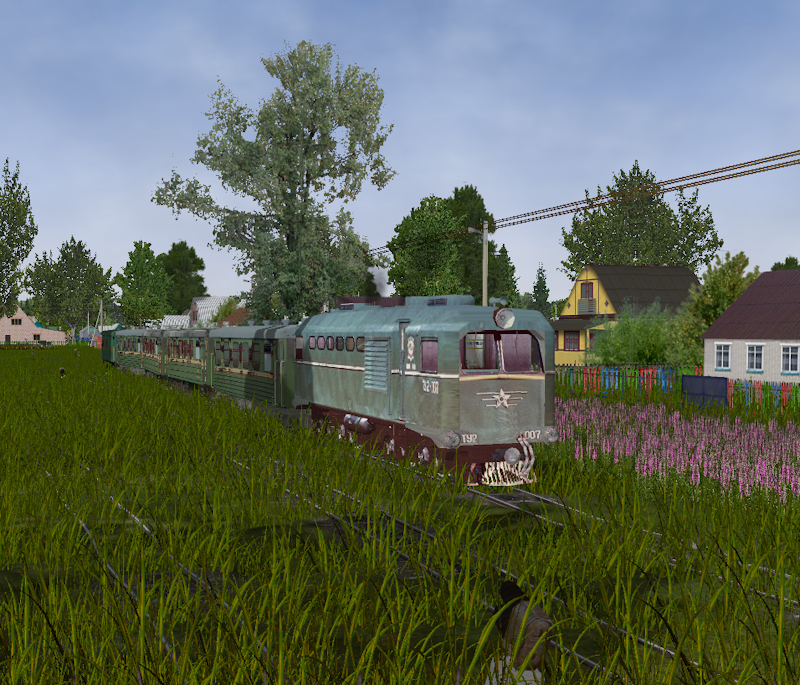

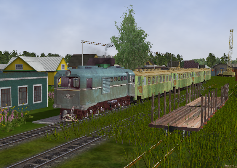

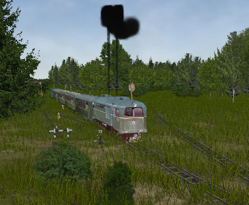

Post  Markh5682 on Tue 25 Oct 2016, 1:16 pm
Hi Vern.
I'm glad you managed to sort it. OK I'll still translate the Russian and try it, but in my own time now, (my arthritis is giving me some pain this morning, so I wasn't looking forward to doing it just yet)
I have taken a few screenshots of the "Industrial community" NG route, I'll come back and post a few later. Very Happy

Post  Markh5682 on Tue 25 Oct 2016, 2:00 pm
A few pics from the Russian NG route.............................................

Post  Markh5682 on Tue 25 Oct 2016, 2:02 pm
Posts : 2547

Post  OldVern on Wed 26 Oct 2016, 8:12 am
Those screenshots look fantastic, hard to think that is MSTS. Doubt my own efforts could come anywhere near that.
Added to my "must try" list of routes, downloading all the bits now.
The rolling stock looks excellent too - there's certainly enough resources there to have a crack at my own Russian ng route in due course.
