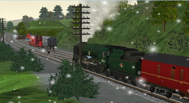

Hi all,
Having studied various videos from the SVR Spring Gala, I am working on as close as I possibly can for an Activity based on this. I am close to finishing it (I think)
The first few screenshots leaving Bridgenorth;
