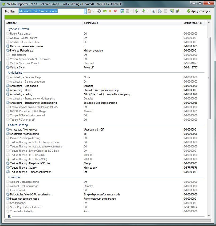

Post  Markh5682 on Sun 29 Mar 2015, 8:51 pm
I have just loaded up the profile and took a screenshot of the settings, I don't think I missed anything.
I clicked the apply changes button at the top right to set them in, do I need to do anything else?

Post  slipperman12 on Sun 29 Mar 2015, 9:20 pm
Hi Mark,
It all looks OK, except for the Negative LOD bias which, as Clive discovered, is better when set to "Allow" instead of "Clamp" (especially when using the high intensity signal lights), but, I hasten to add, it has no effect on the shimmering/moire effects!
You've named the profile as "Microsoft Train Simulator - new" - have you linked that to train.exe in your MSTS installation?
If so, I can't think of anything else to suggest - Sorry!

Post  Markh5682 on Sun 29 Mar 2015, 9:24 pm
Hi Ged
No I have not linked it to train.exe, I'll go back and do that now and report back if it works or not.
Thanks, Mark.
Posts : 2542
Age : 62
Re: NVIDIA Graphics Card settings
Post  Markh5682 on Sun 29 Mar 2015, 9:40 pm
Hi Ged.
Just had a quick run on Dorset coast out of London (no stuttering with this new card) and your suggestion worked, it looks a lot better now OK I knew I must have been missing something, I had to delete the association with the default MSTS setting before it would allow me to associate it with mine, now there is hardly any moire effect at all. Smile
Thanks, Mark.
